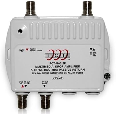

You might try a booster/splitter right at your TV/Tablo interface. Not so many bucks to risk.
Example:
Good suggestion. I ordered one. Had already tried an additional in-line amplifier at the TV end when I was just working with the TV - antenna combination, but really couldn’t tell much difference. (The antenna has it’s own amplifier.) Hadn’t tried that with the Tablo yet. Thanks.
