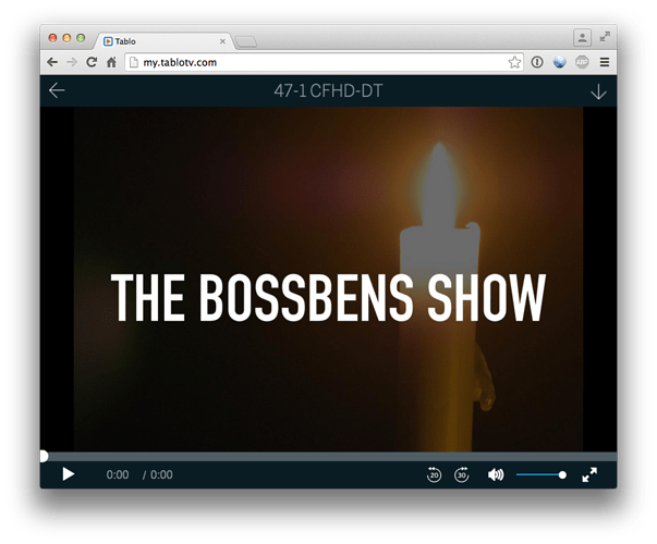

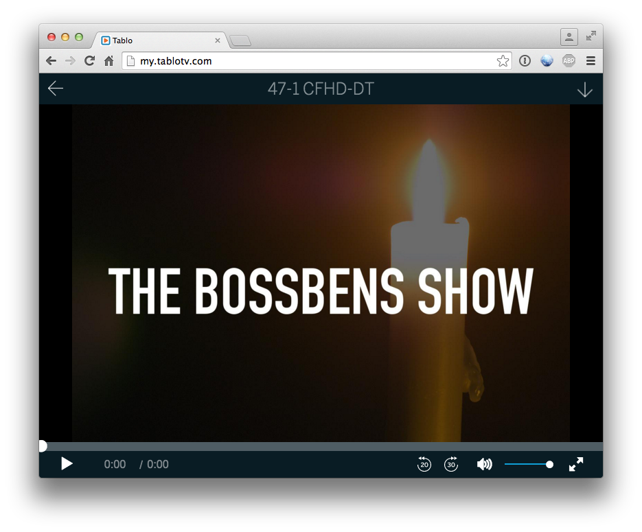

I concur with @JCmontreal, this channel will not start.
I personally get an infinite loop when I tune it, this is probably because I dont have an active subscription, else I’d probably get an image like on the screenshot posted. Tried on Chrome browser / iPad Tablo app as well.
I also did a rescan and same result, that’s pretty weird.
