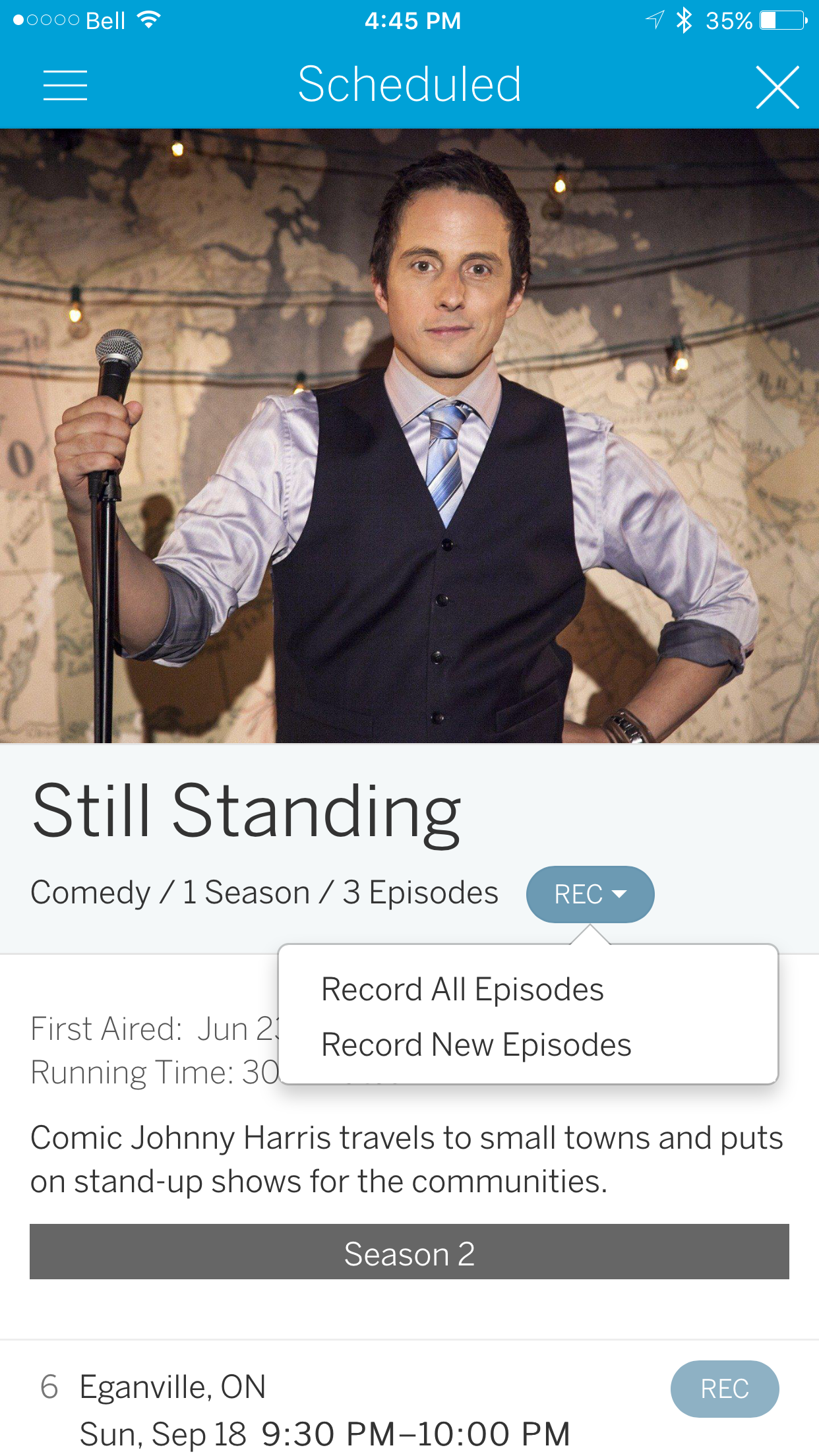

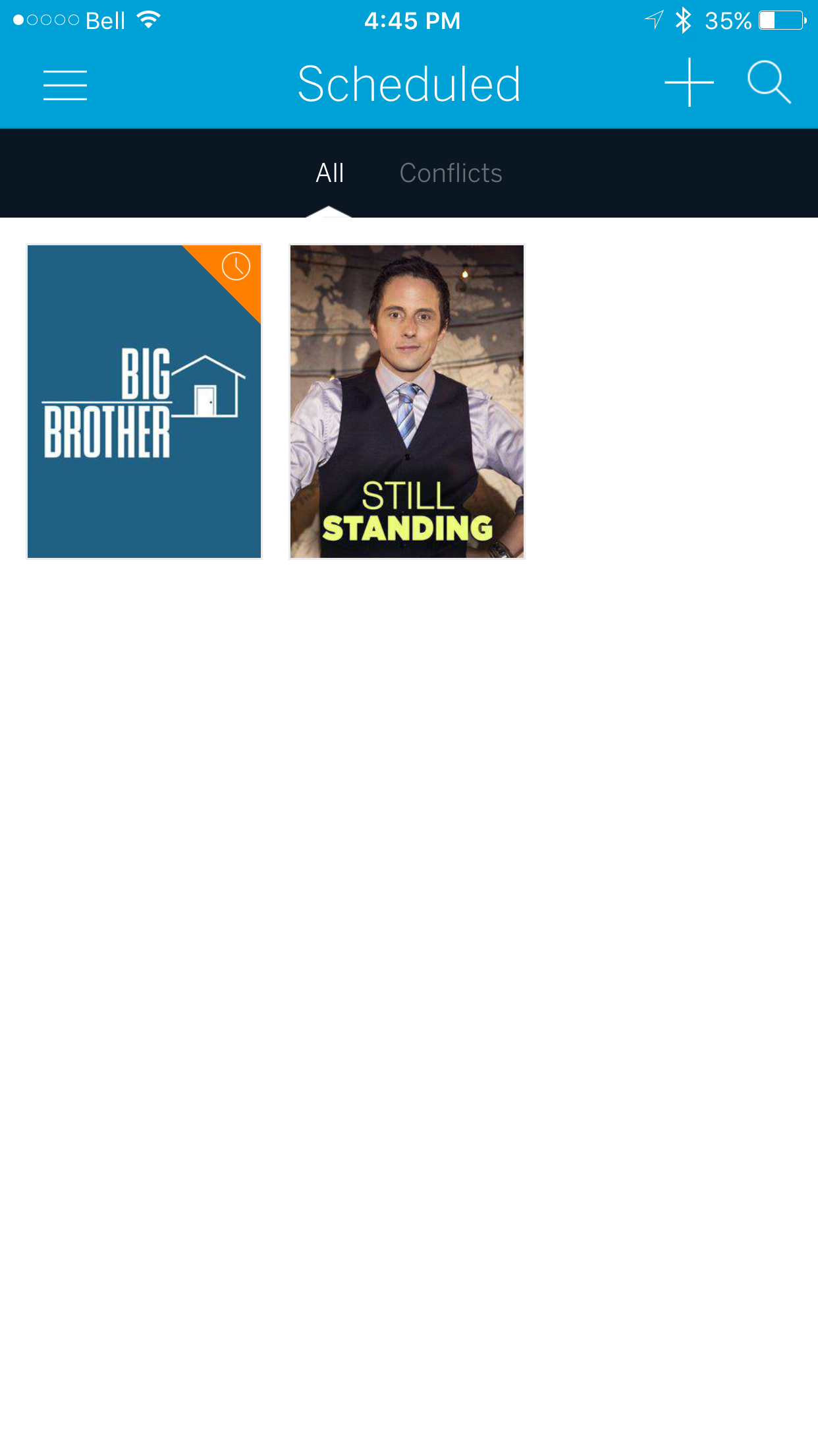

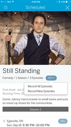

So I just purchased the Tablo subscription and it automatically set a series recording for a couple of shows I assume we’re suggestions based on my OTA channels. I didn’t want any of them and was able to erase all but one. I’m left with this one crappy show, none of the “record buttons” are selected (the buttons remain grey) but it will not let me delete the crappy CBC show. See attached pics. Any advice?
If it is grey like that, the show is no longer scheduled. If you refresh your screen (or just exit and come back in), it should go away from the scheduled page.
This happened to me when I removed a channel from the Tablo’s channel list that already had a scheduled recording for that channel.
I had to add the channel back in before I could delete the scheduled recording on that channel.
Yeah, that did it. Removed and then re-added the channel
and it’s gone. Thanks man.
Interesting bug.
@MisterJoji That is interesting. Sending this to our team to check out.
