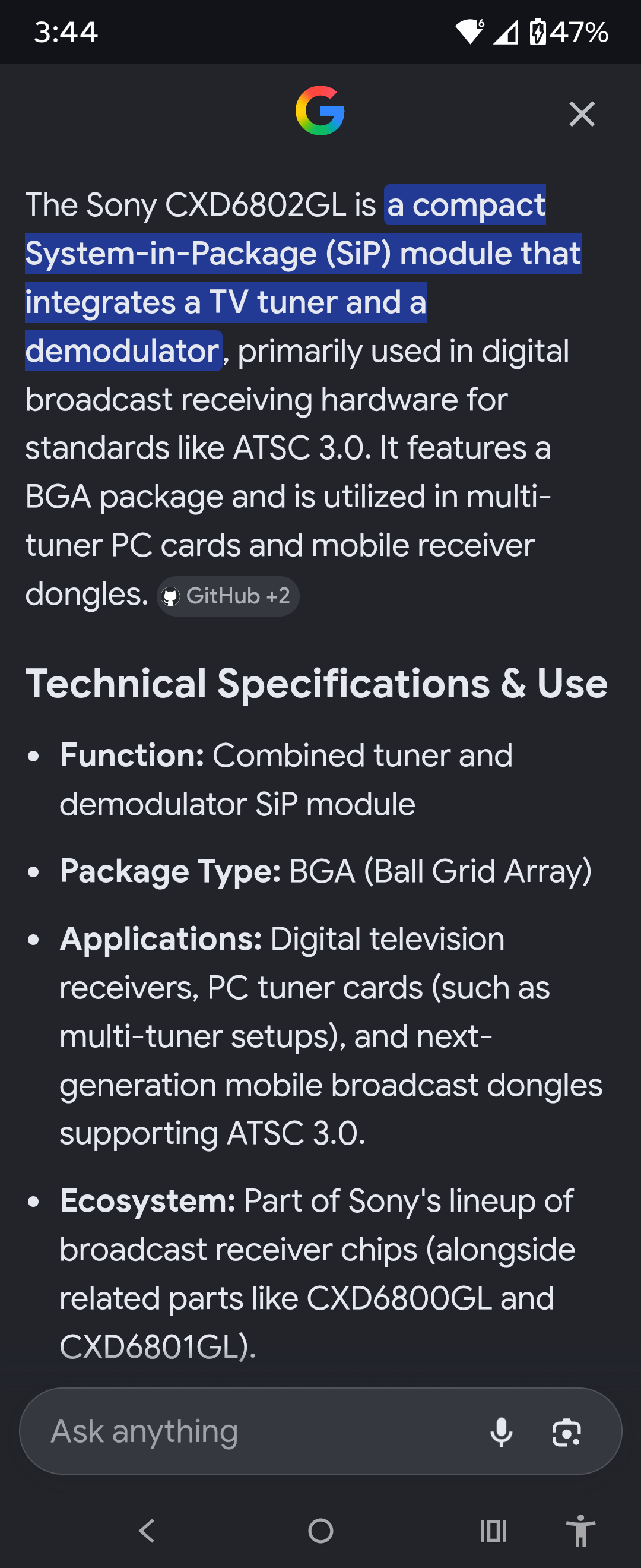

Surprising. Are you sure? I mean, when I say “surprised”, I guess I mean very very surprised. Of course, licensing is a “factor”, but that too would be easy if what you’re saying is true. Different codecs in ATSC 3.0, both in terms of video and audio.
Wouldn’t you also need different tuners/hardware?

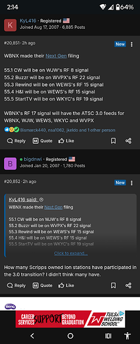

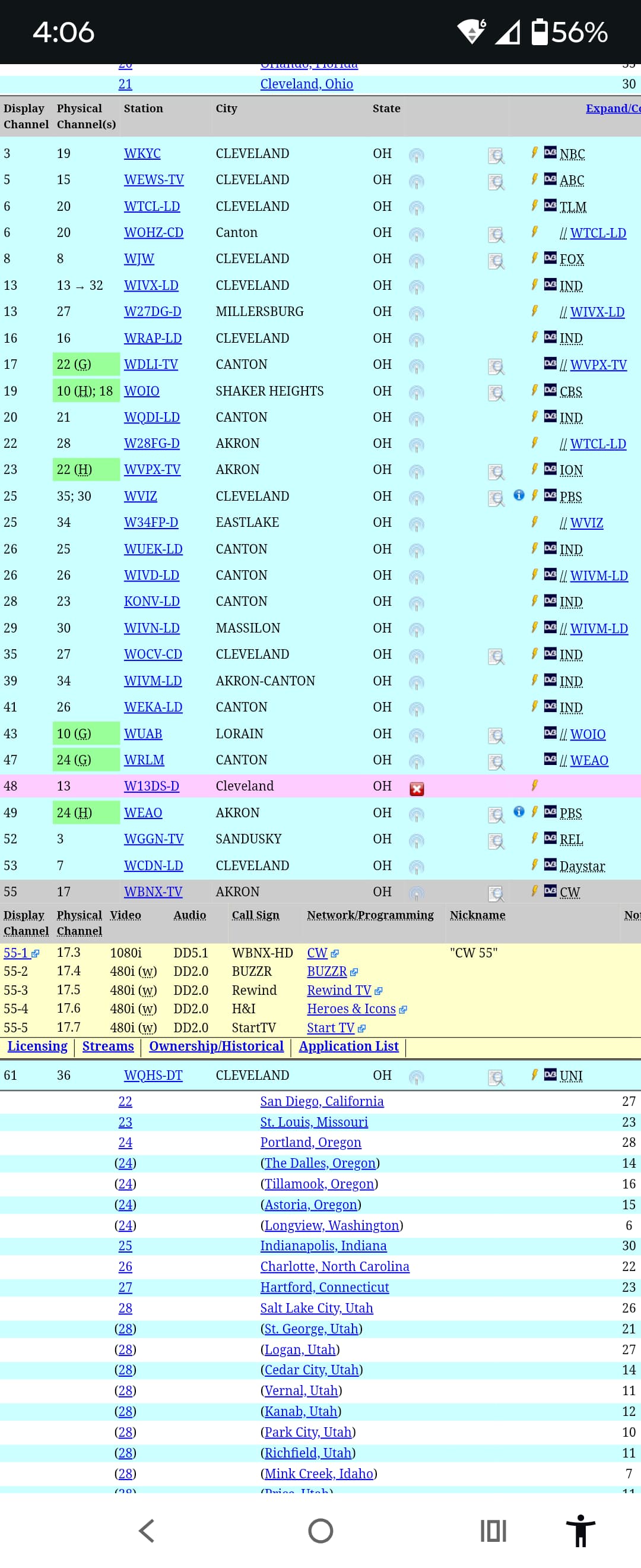

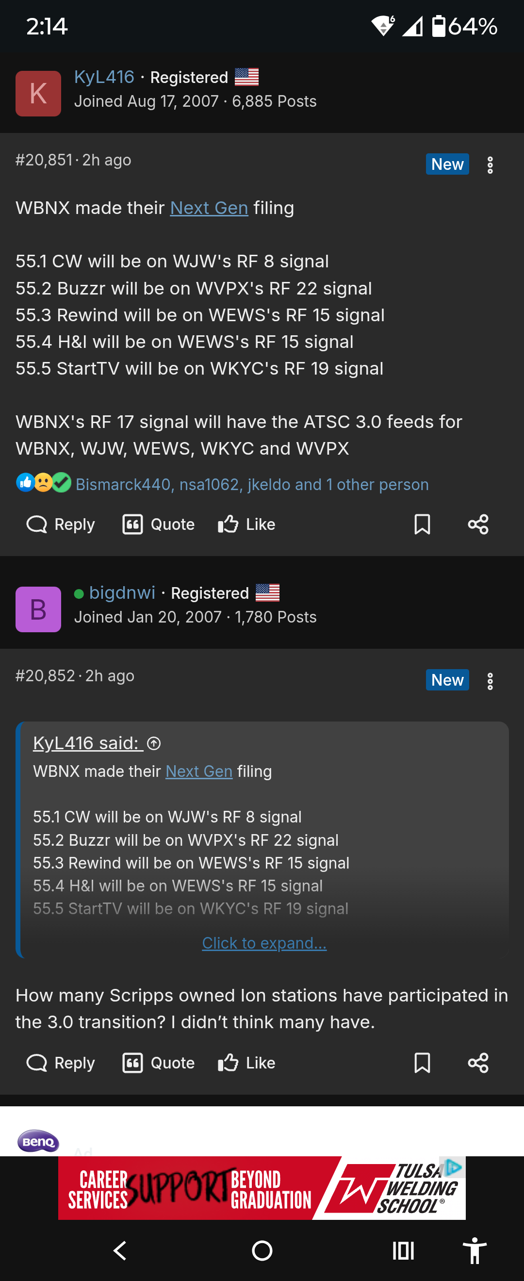

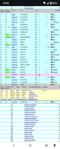

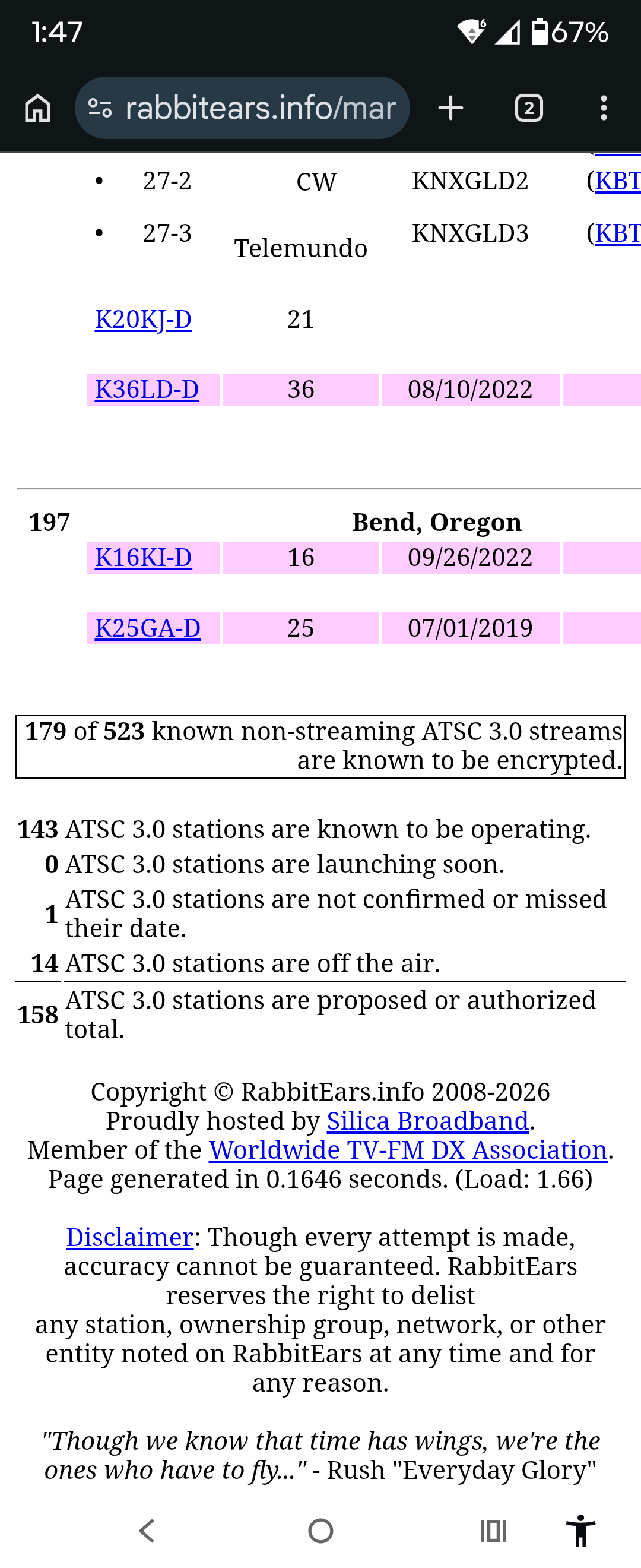

It appears WBNX 55 your CW affiliate is the only CW affiliate.
There are no other ATSC 3/Nextgen stations in your market.
AFAIK the FCC still requires the station to provide the “equivalent” broadcast. Meaning somehow they have to provide a broadcast of 55.1 in a format that can be viewed by consumers using equipment they have today.

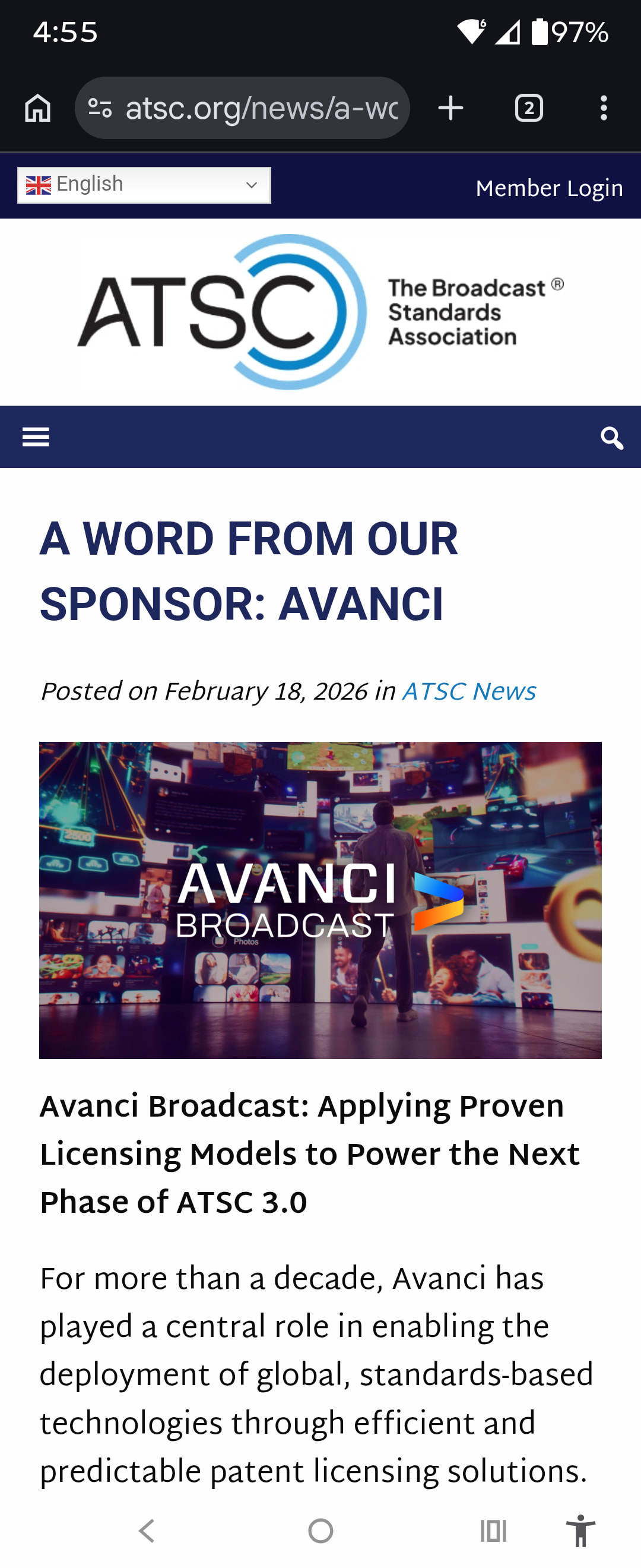

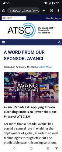

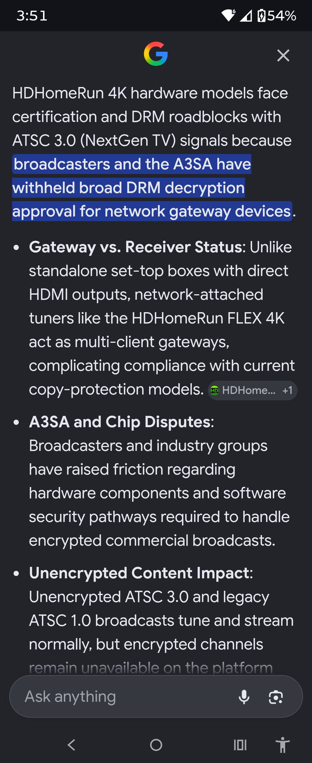

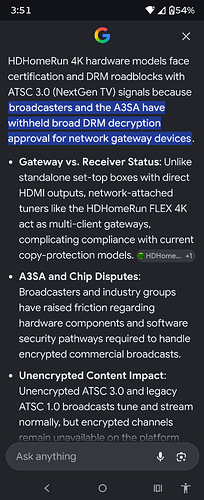

Has anyone been releasing new terrestrial tuners in the last 6-8 years that didn’t support ATSC 3.0. You can only turn the functionality on if someone pays the patent royalties. So this functionality is locked down.

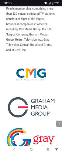

Opportunity knocks. CES wanted low cost boxes.
Pearl can waive those fees.
HDHomeRun and Zapperbox…
What does pearl have to do with it.

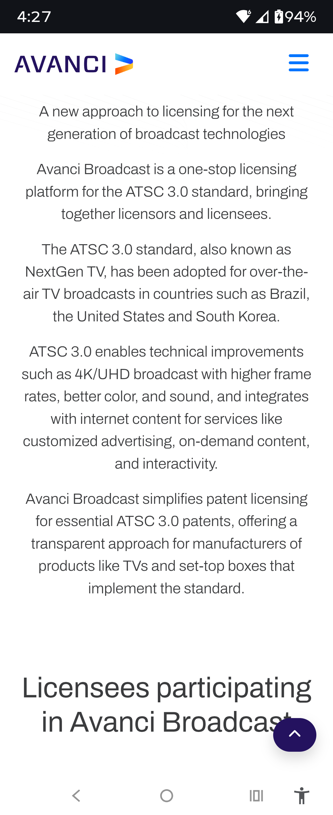

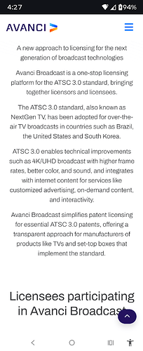

ATSC 3.0 (NextGen TV) patent royalties are managed through major pools like Avanci Broadcast and Via Licensing Alliance charging $2 to $3 per unit****, though non-pool patent holders can demand higher individual fees. [1, 2]
Patent Pool Rates and Structures
  • Avanci Broadcast Pool: Charges roughly $2 to $3 per unit covering a large percentage of standard-essential patents with major backers like Samsung, Sony, and LG. [1, 2]
  • Via Licensing Alliance Pool: Offers a single joint license for core ATSC 3.0 features, also pricing under $3 per unit. [1]
  • Promotional Waivers: Pools occasionally offer incentives, such as Avanci Broadcast waiving fees for the first 75,000 units for new set-top box or dongle makers

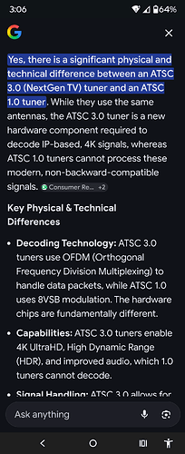

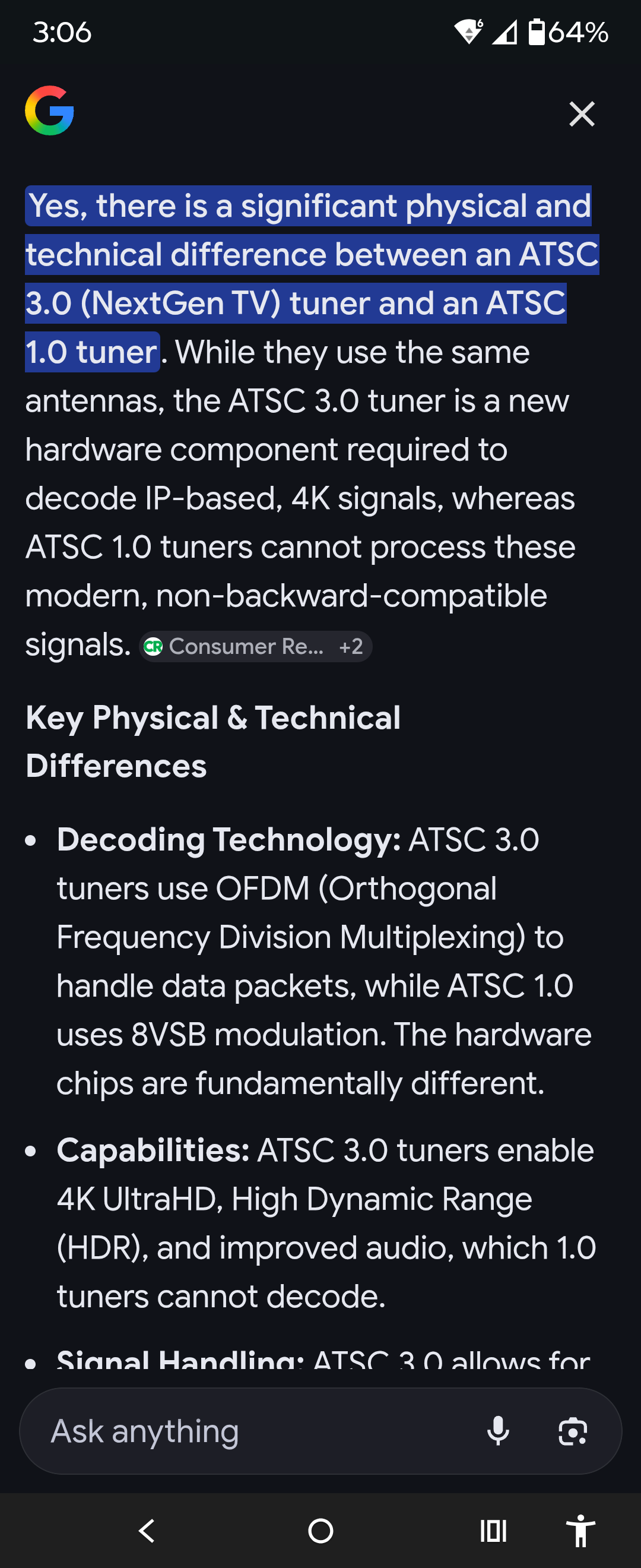

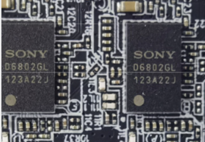

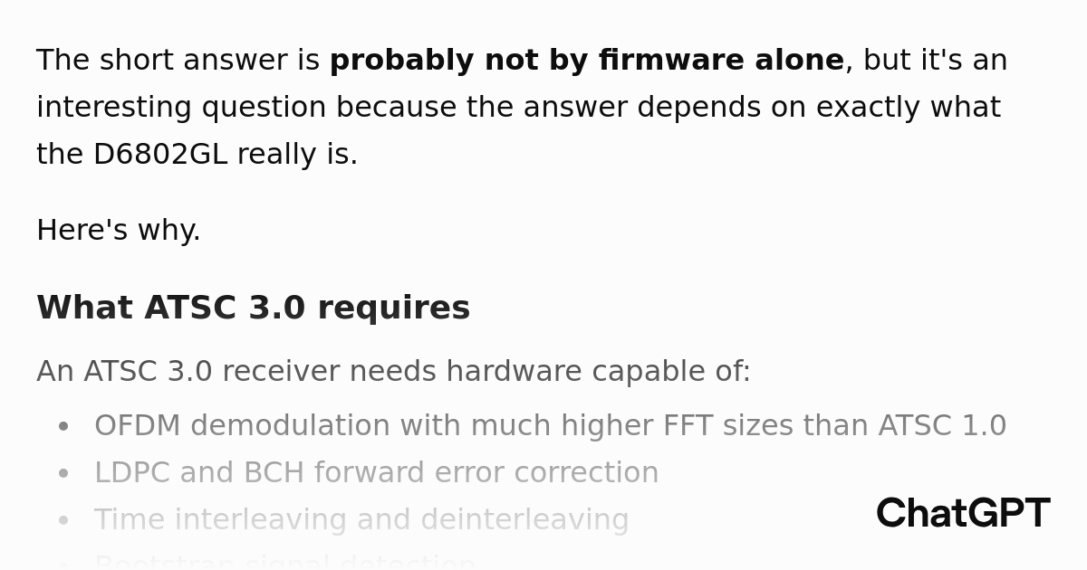

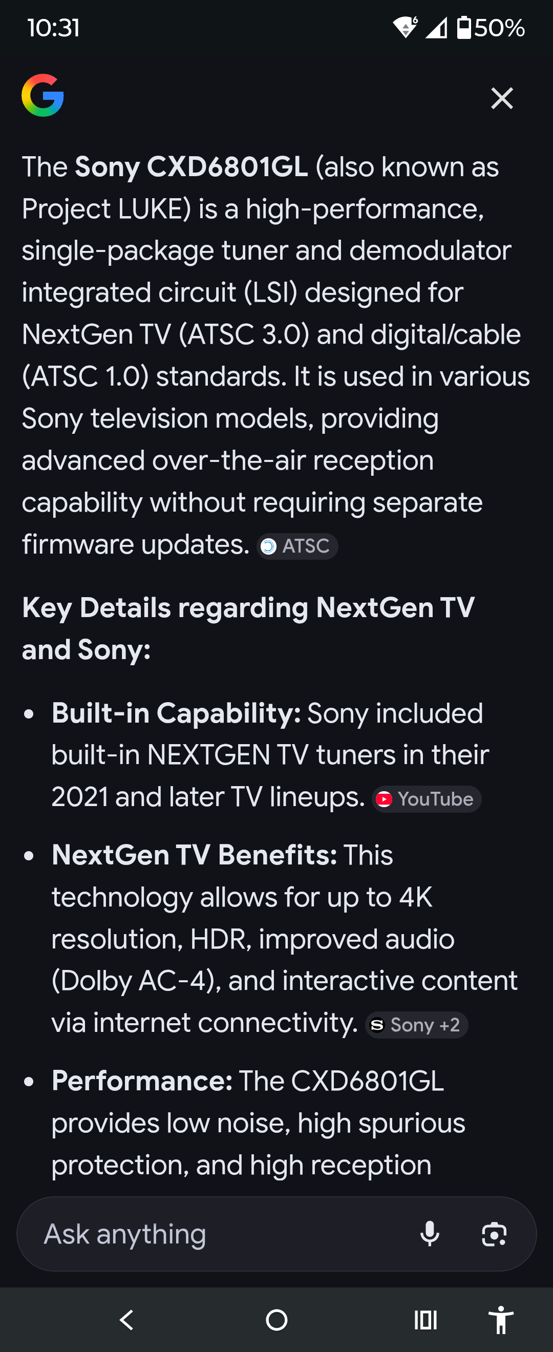

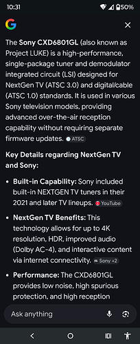

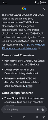

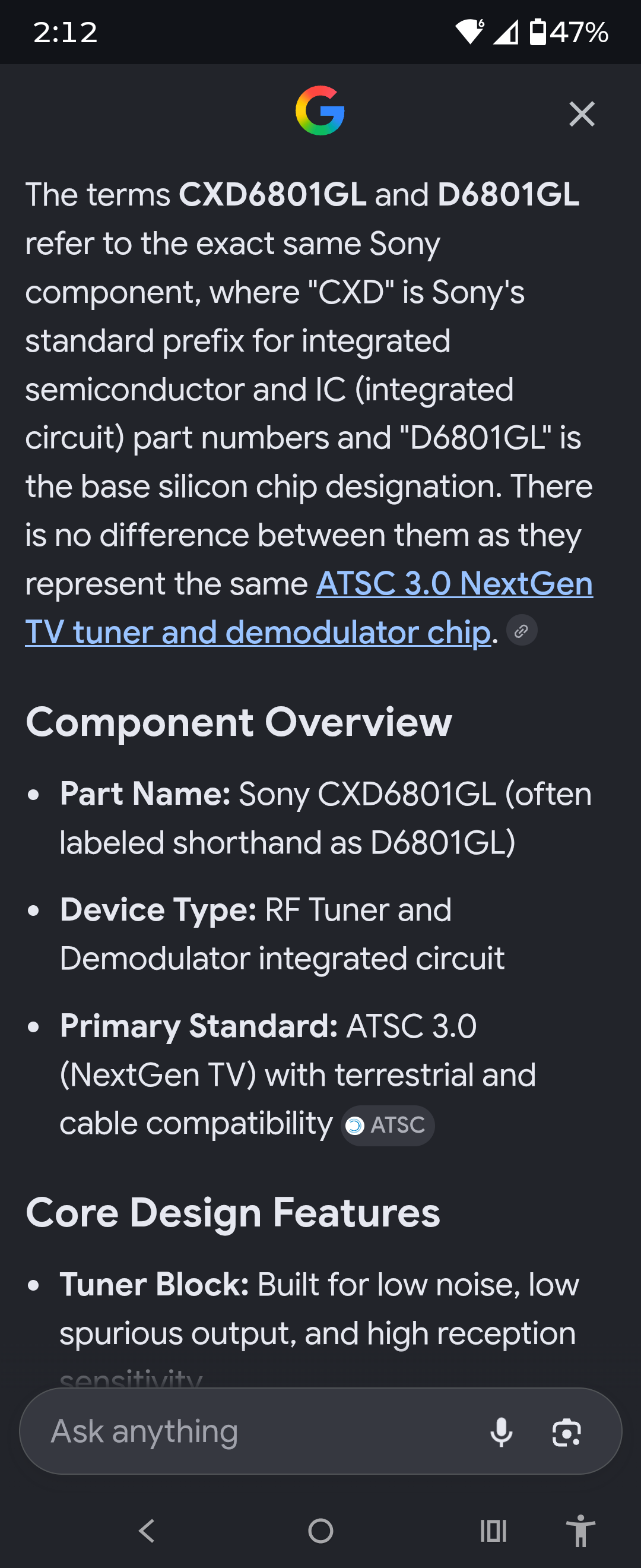

Based on this information, I’d say there’s about a 20% chance that the existing device can support ATSC 3.0. It boils down to having all the correct parts in the proper places. Only Tablo knows.
If you get to the bottom of the ChatGPT thread, it has a section “what would settle the question”…
As usual you are correct. Lots of facts.

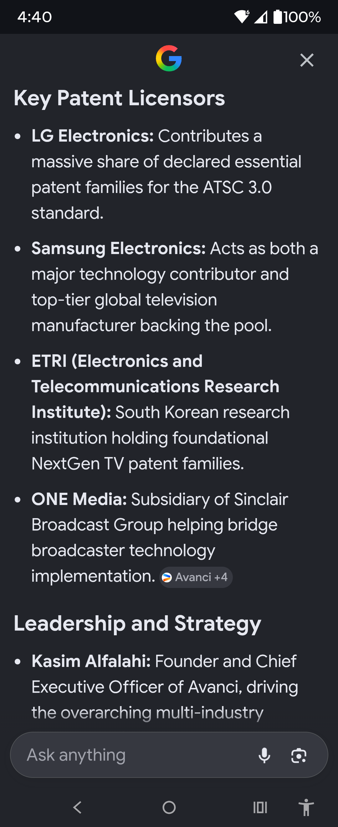

The patent pool is controlled by…?
Reality notwithstanding the logjam will break.
The patent pool is controlled by ATSC org. Do you have a lot of devices that support AC-4. Only STB Roku Ultra 4802 and up and the 2023 fire tv stick 4k max. I don’t think appletv supports AC-4.
Sorry that is incorrect.
I used the term controlled because there is a difference between who controls what is in the pool and who manages(collects fees) the pool. If ATSC org knows what patents are required but didn’t like the Avanci costs they might use someone else.
Many different companies participated in the ATSC 3.0 standard. If I remember correctly early pre-approved standards were littered with patent disclosure information from those companies.

ATSC is a not-for-profit standards group. They write technical specifications (documentation). They hold zero patents and have zero control over patents.
