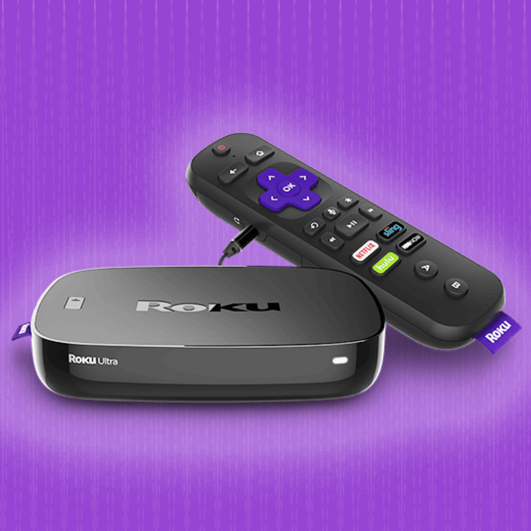

Our latest list of recommended devices is here:

If I want to replace my old Roku Sticks what model or models do you recommend?

I have a Netgear WNDR4300 that sits 16 feet away from the TV. 5GHz streams tablo 5 Mbps videos like a champ to a Roku 4200, Roku Ultra, and gen 2 Fire TV stick.
But the cpu in the Roku 4200 is 50% faster then your 3500x.

But I would always start with replacing the Roku with a new higher end model. It will provide better performance for all OTT apps. And I think the video display of my 4661 ultra is better then the 4200 when viewing the same recording.
