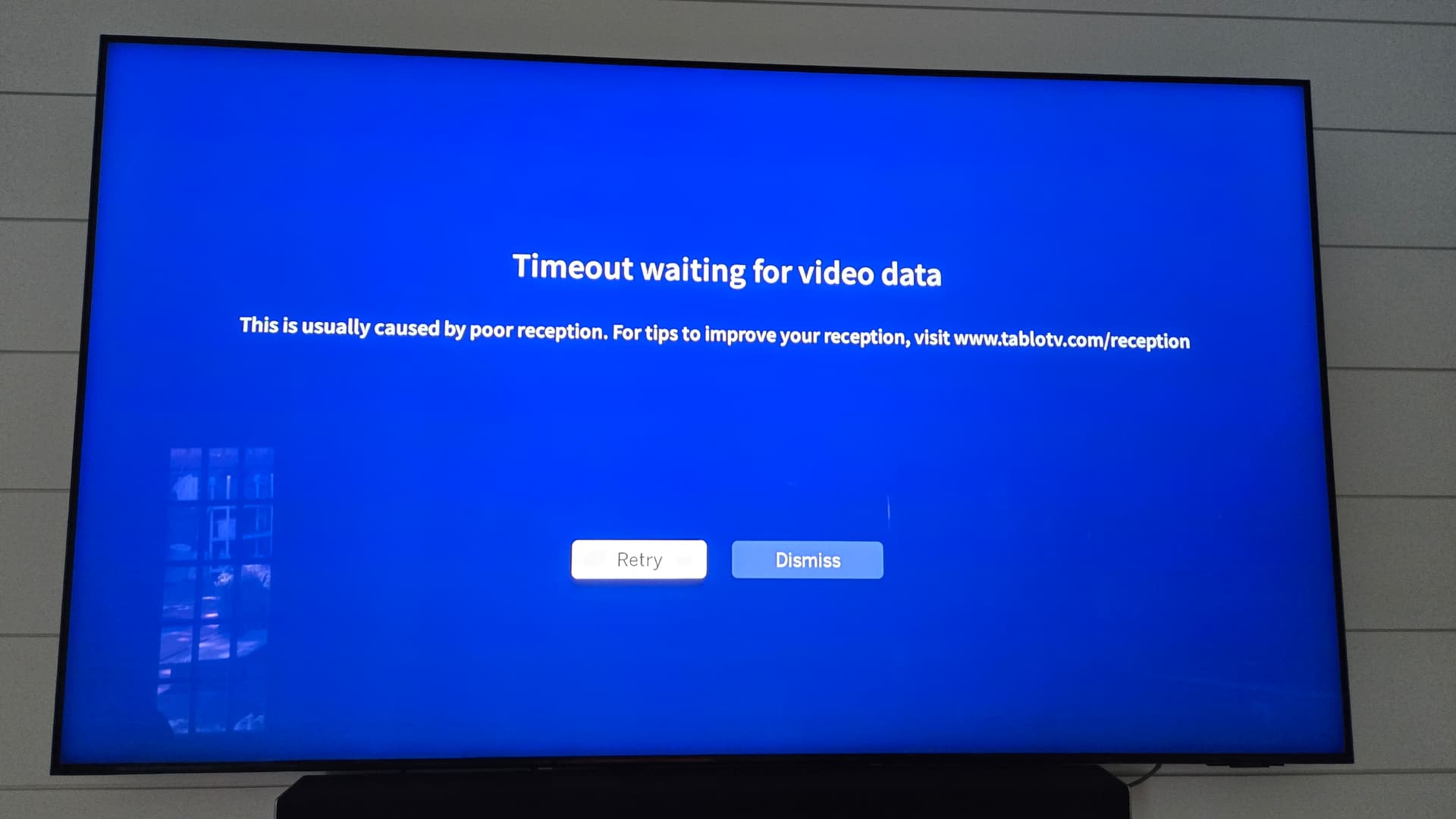

We had this buffering and skip back/repeat occur a few times today while watching Kelly and Mark on Fox in D/FW market. Very interesting. I tried to get a video of it after occurring 3 different times, but it didn’t happen a 4th time. However, this screen eventually comes up.
