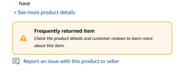

Also, it’s wise steer clear of Amazon items that show this under the product description.

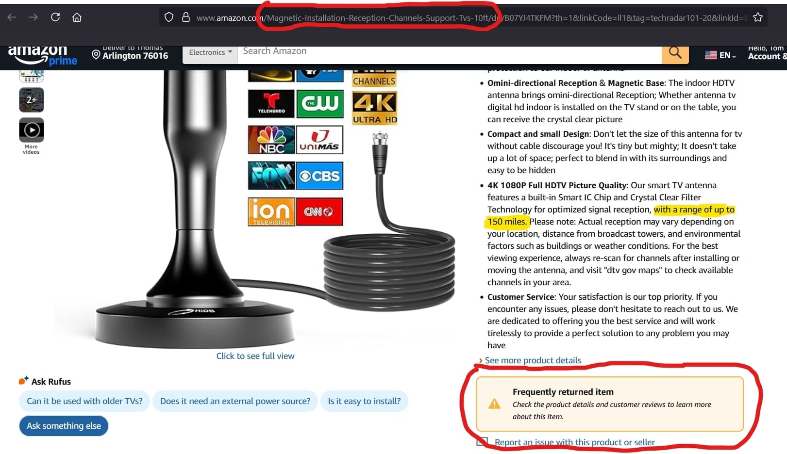

  • HIDB TV Antenna for Smart TV Indoor
https://www.amazon.com/Magnetic-Installation-Reception-Channels-Support-Tvs-10ft/dp/B07YJ4TKFM/?th=1
It is not correct to say this is frequently returned item.
please check customers review on amazon.
For anyone in the Tablo Community looking for a functioning antenna, I do not and would not recommend this antenna for any reason because there are far better devices that will perform better at this price.
You can see that it makes a claim in the Amazon page below that the device is capable of receiving channels up to 150 miles. This is just about impossible for most terrestrial antennae.
It also shows clearly under the product description that it is frequently returned, likely because it doesn’t provide the reception users expect. It may work if you live within a very small distance from towers (<5-7 miles), but it probably a UHF-only antenna. This means you may not receive all the channels in the Low or High VHF bands (RF 2-6 and 7-13). The Philips rabbit ears antenna comes more highly recommended and would probably pick up the VHF channels. So if you want to spend $10-$20 to try an antenna, consider the rabbit ear antenna that the Antenna Man recommends. I would recommend the rabbit ears too for indoor use.
