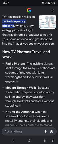

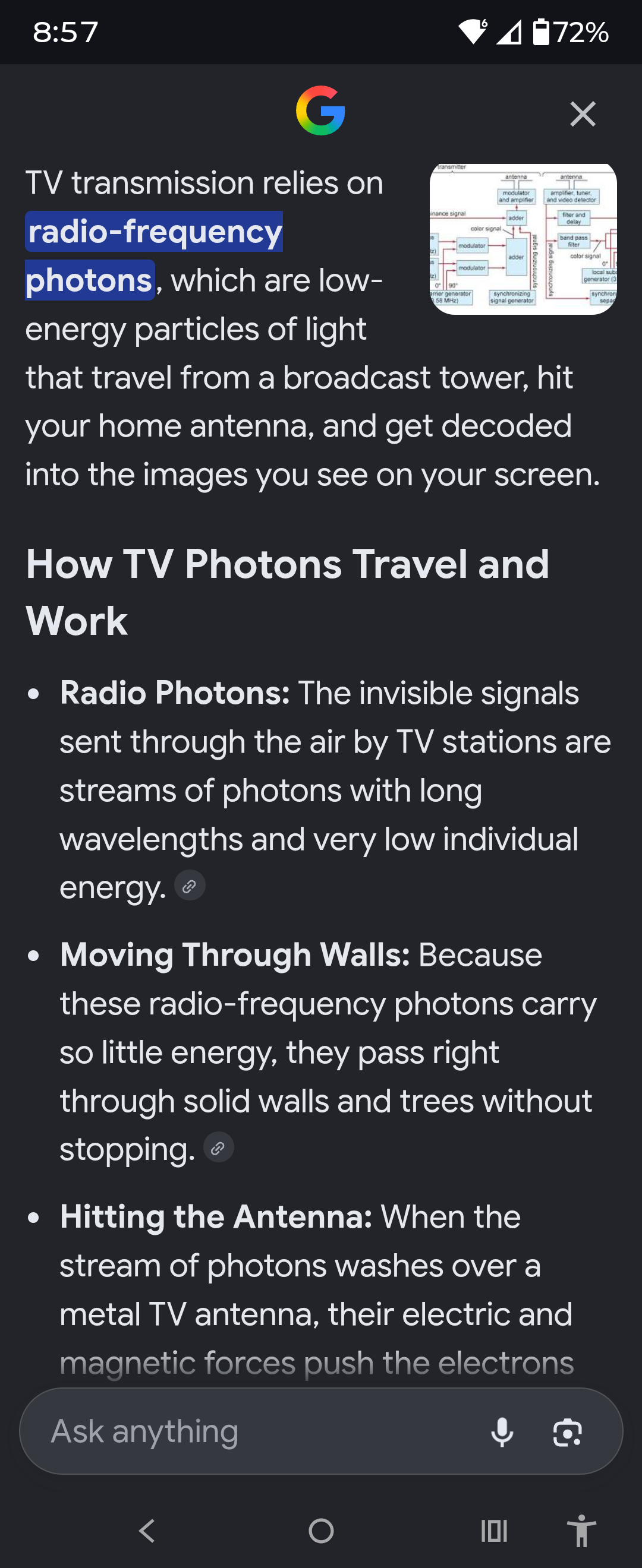

KNAV 22 still is too weak. It scans and locks but can’t gather enough photons to assemble a signal.
