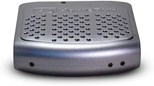

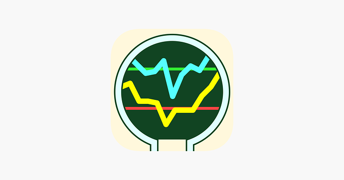

Not sure how much money you want to spend tracking this down but if you get a HDHomeRun and a iPad app you can get live signal strength outputs for your channels and see if the signal for that channel is see sawing.
I used this setup to dial in the direction my antenna was pointing.
I believe there are also Android apps. I just used my iPad.

When I used the iPad app and the HomeRun I found that there was a sweet spot for the angle of the antenna that improved the weakest signal and did not hurt the others.
I have a Homerun device. Not everyone wants to put out the money just to find the best antenna location.
