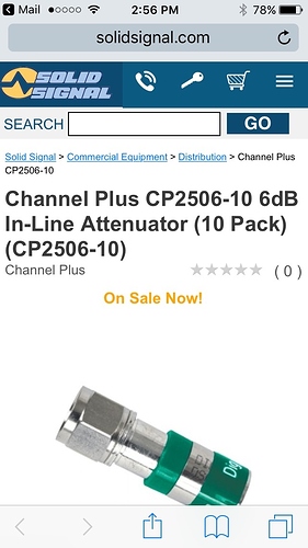

If you suspect a problem with overdriving your Tablo (especially when using an amplifier) Solid Signal has a sale on in-line attenuators that can let you mix and match as you desire.
I had to use them on my system to prevent overdriving my distribution amps with the output from my antenna amp.
Cheers!
