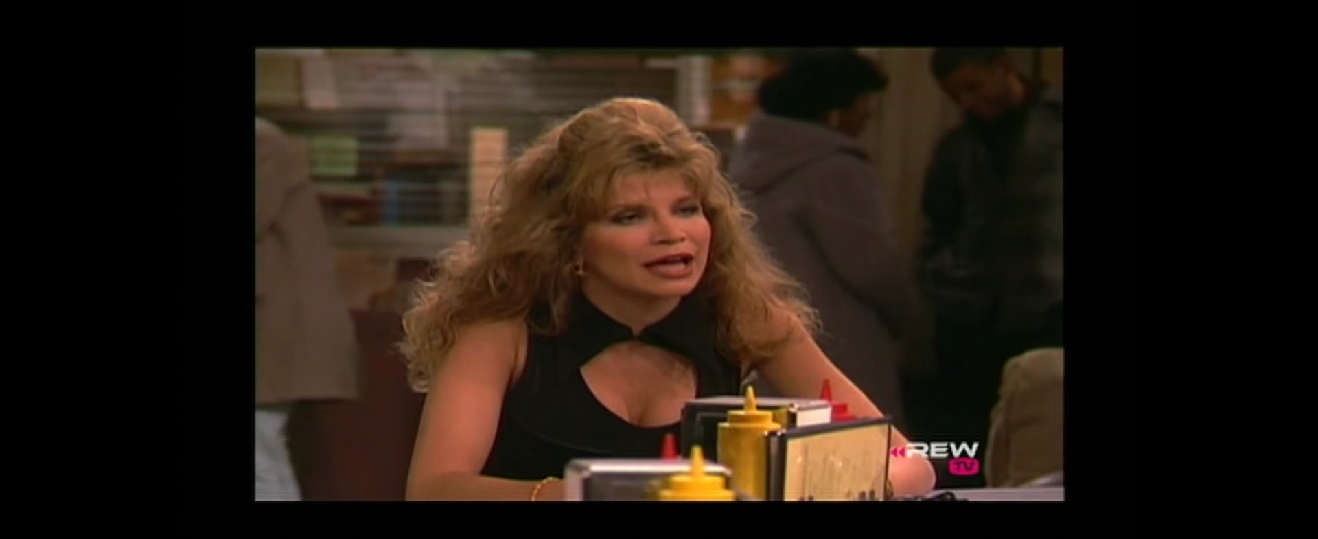

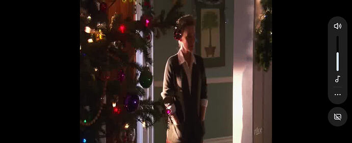

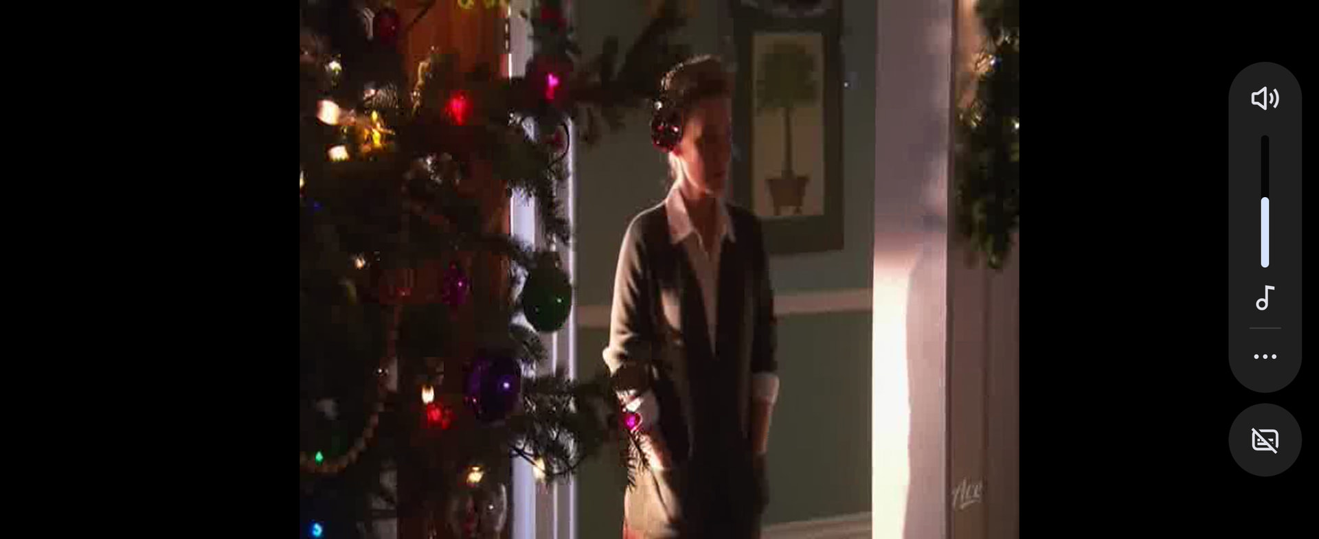

Side pillar black bars. Blue on the Gen4 sometimes - Fire Stick 4k G2. Squished vertical video. Stretching. I can’t watch it. Android mobile app.
I read something somewhere that it relates to 480i being transmitted 480p by the originators feed. Who knows? These are all 480i from the station.

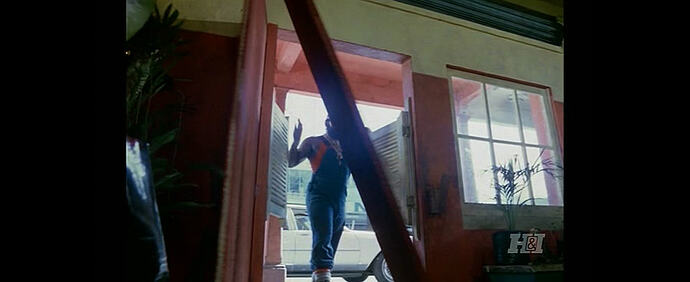

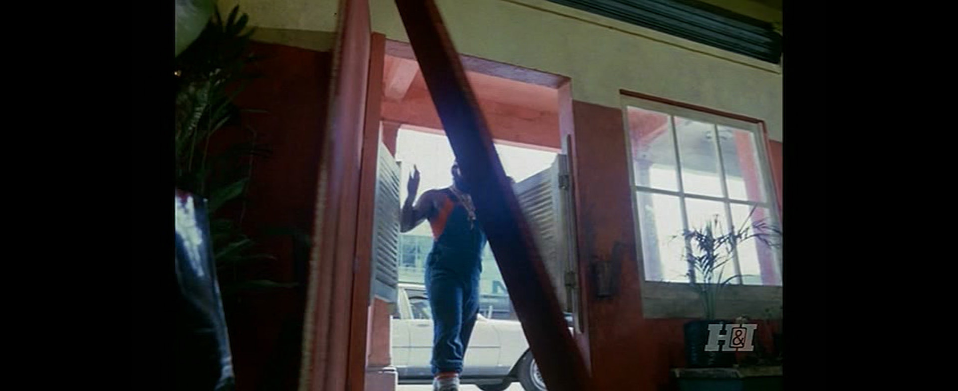

Each of the diginets is different. H&I is ok… Kinda letterbox.

These two are ACE and Rewind.
