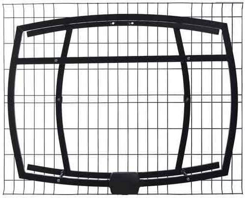

Your issue is ABC is a VHF channel rather than UHF channel - the Clearstream is a great UHF antenna.
Get a separate VHF antenna.
Which vhf antenna should I get? Any recommendations, and then what’s the best way to combine them to use with the Tablo?
Use this preamp to combine the UHF and VHF antennas. It is installed closest to the antennas.
And the Clearstream 5 is a good VHF antenna.
Both of those will likely solve your problem.
