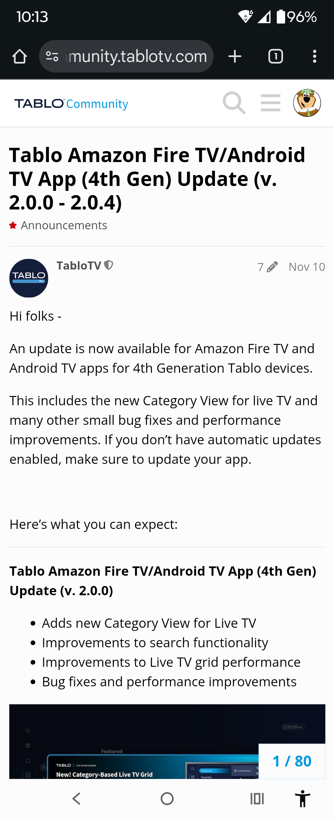

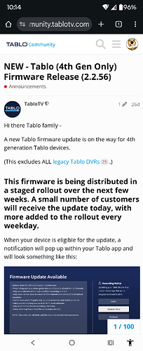

For over a month Tablo has been rolling out software updates. As a result they introduced unforseen bugs and errors. This resulted in more hot fixes which fixed one problem and introduced others.
Your attempt to resolve your issues will exhibit unpredictable results as the app and firmware was in flux.
Further server/infrastructure constraints produced more undesirable performance timeouts and weird results. Including data corruption.
TCL Android TV app version 2.0.5 just became available December 8. As the firmware version 2.2.56 last week became generally available.
