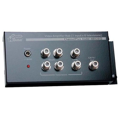

An amplified splitter is probably best if you have serious issues.
Such as…
