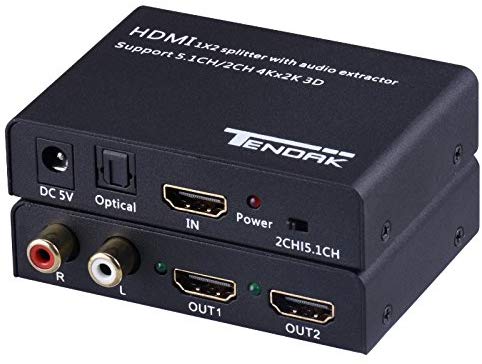

maybe one of these would do the necessary magic to pass AC3 to my soundbar without involving the TV

This is the one I have, it works well. It can extract the AC3 audio from the HDMI. This is an HDMI switch versus a splitter which is what you posted. Can take input from 4 devices.
Another option:

It looks like what I need is the audio extract feature and use a sound bar to do the decoding. It’s still curios to me why the TV optical out doesn’t do that for me.
