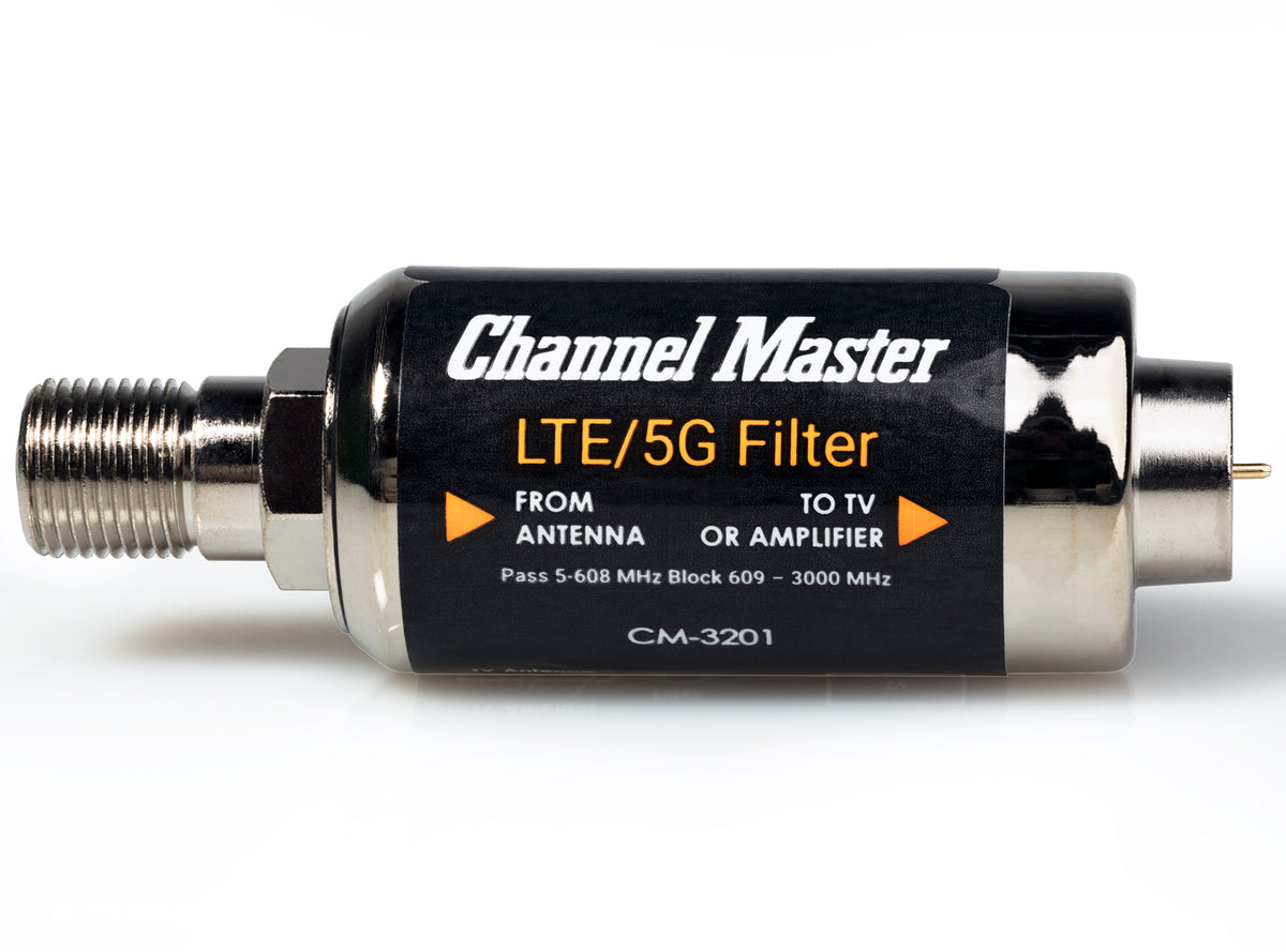

So my question to anyone that may know. If my antennas have built in amplifiers and LTE filters (assumed 4G) would it work for me to add a 5G filter at my TVs or Tablo? From what I’ve read the filter should either be between the antenna and amp (not possible for me) or to place it at the end of the cable run just before it goes into a TV (or Tablo).
LTE filtering parameters changed after the repack I believe. I believe older filters may not be adequate (old filters started at 700Mhz . Newer ones start at 600Mhz). Also, filtering does add a minimal amount of signal loss (even for the TV spectrum). They are pretty cheap, so you could try it without a great amount of investment. I believe you could put it right at the Tablo.
