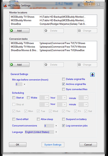

That’s it. MCEBuddy will do all of it once Tablo Ripper hands off the ripped (concatenated) mp4 file. All that is necessary is to set various settings, set monitor folder(s)/output folder(s), Conskip folder, and about a dozen other necessary settings I’d have to look at again to remember. Once their set, you can assign how much effort you want MCEBuddy to use by allowing anywhere from 1 to 8 concurrent jobs. In Tablo Ripper there are far less settings to contend with. Both Tablo Ripper and MCEBuddy work with a background services that you can enable or disable as you wish.

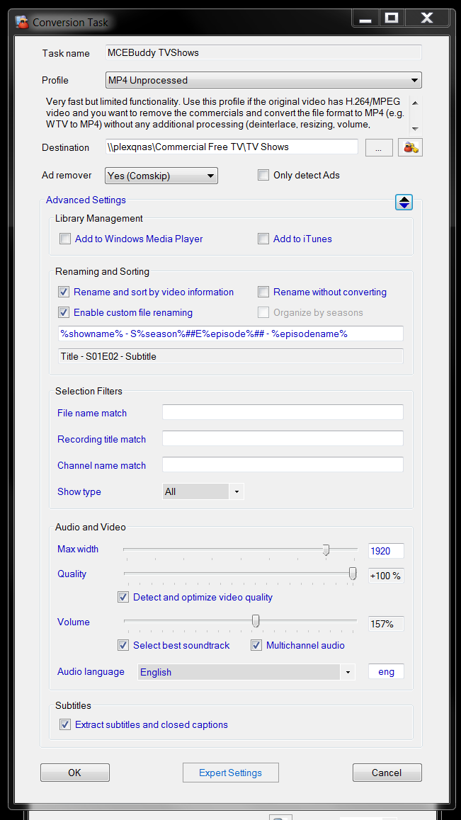

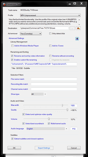

You don’t want to re-encode the MP4 file, just smart render it. To do this, you have to select MP4 unprocessed. Anytime you re-encode you lose quality, always. You may not see it always, but it is always lower quality. So obviously the thing to always try and do is smart render, which means it will only re-encode (re-render) portions that have changes in them or need to be re-encoded do to the mechanics of the filetype you are working with.

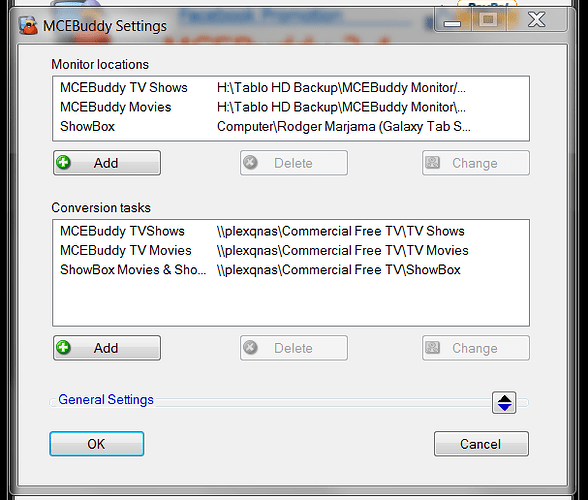

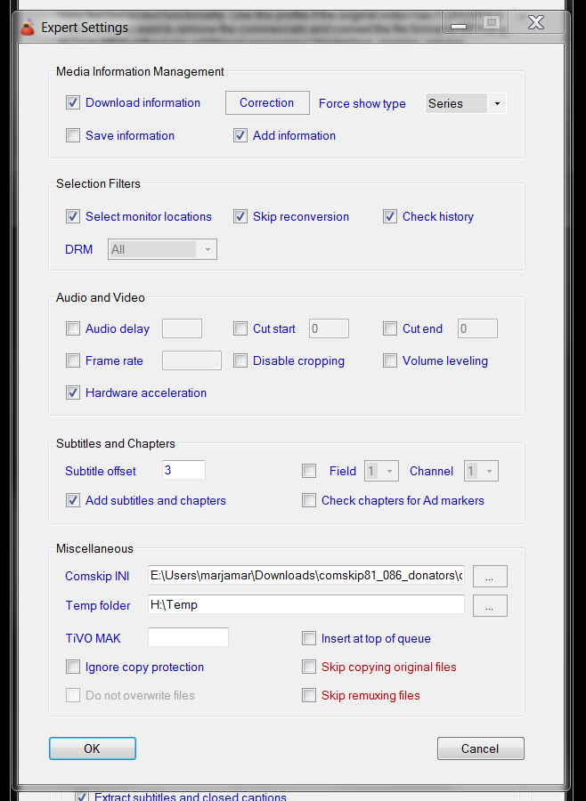

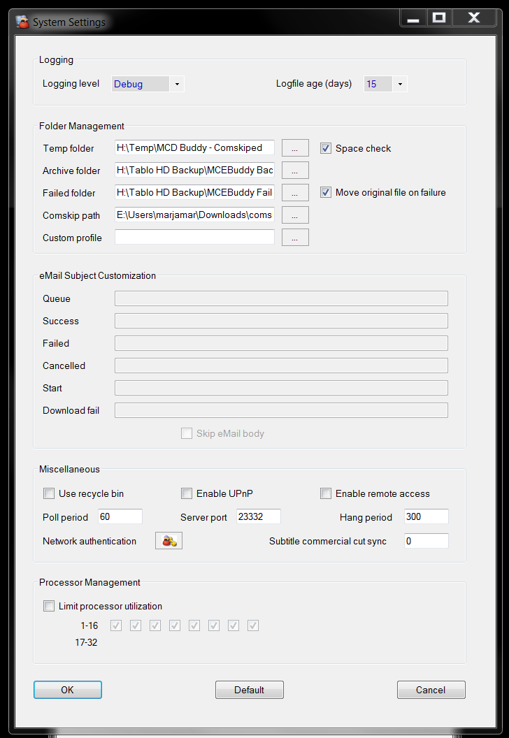

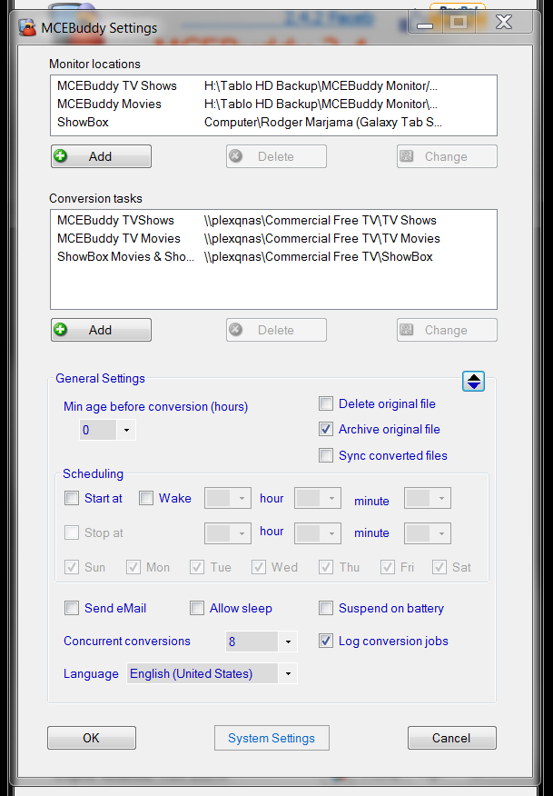

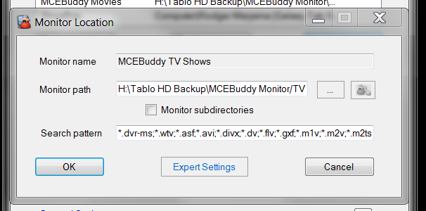

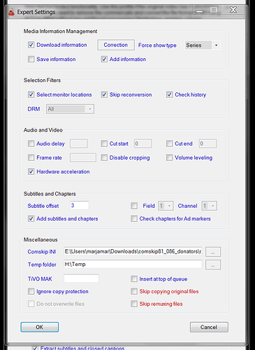

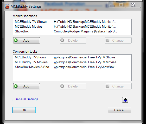

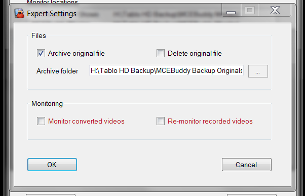

I think I will post my setup screens here as it might be the easiest way to figure this out for you. If you still have specific questions, it will also help “point the way”, rather then just use words, which often are harder to deal with. Especially if I’m the one talking, HA!
Take a look and see if these help.

@marjamar I’ve got the donate version of both MCEBuddy and Comskip and using the “unprocessed” profile it still takes over an hour for a half hour show. Weird thing is, it’s only using 3-4% of my CPU and whether or not I have the hardware acceleration on. I have got to be missing a setting somewhere.
Did you specify the correct version of Comskip in your MCEBuddy setup? Doesn’t matter where you have it, just that you point MCEBuddy to it and not the built-in comskip which is slowed way down. I convert 8 files at a time on my system and an hour show converts in maybe 10 minutes or so. You said you’re using unprocessed profile so only thing rings a bell is to make sure you have and are using the donator version of Comskip.
-Rodger
Point to note there, the free version of Comskip that comes bundled with MCEBuddy slows down processing of MP4 files to 1x (i.e 30fps), so if you have an hour long show it’ll take an hour to scan it. The donator version of Comskip removes that restriction.
