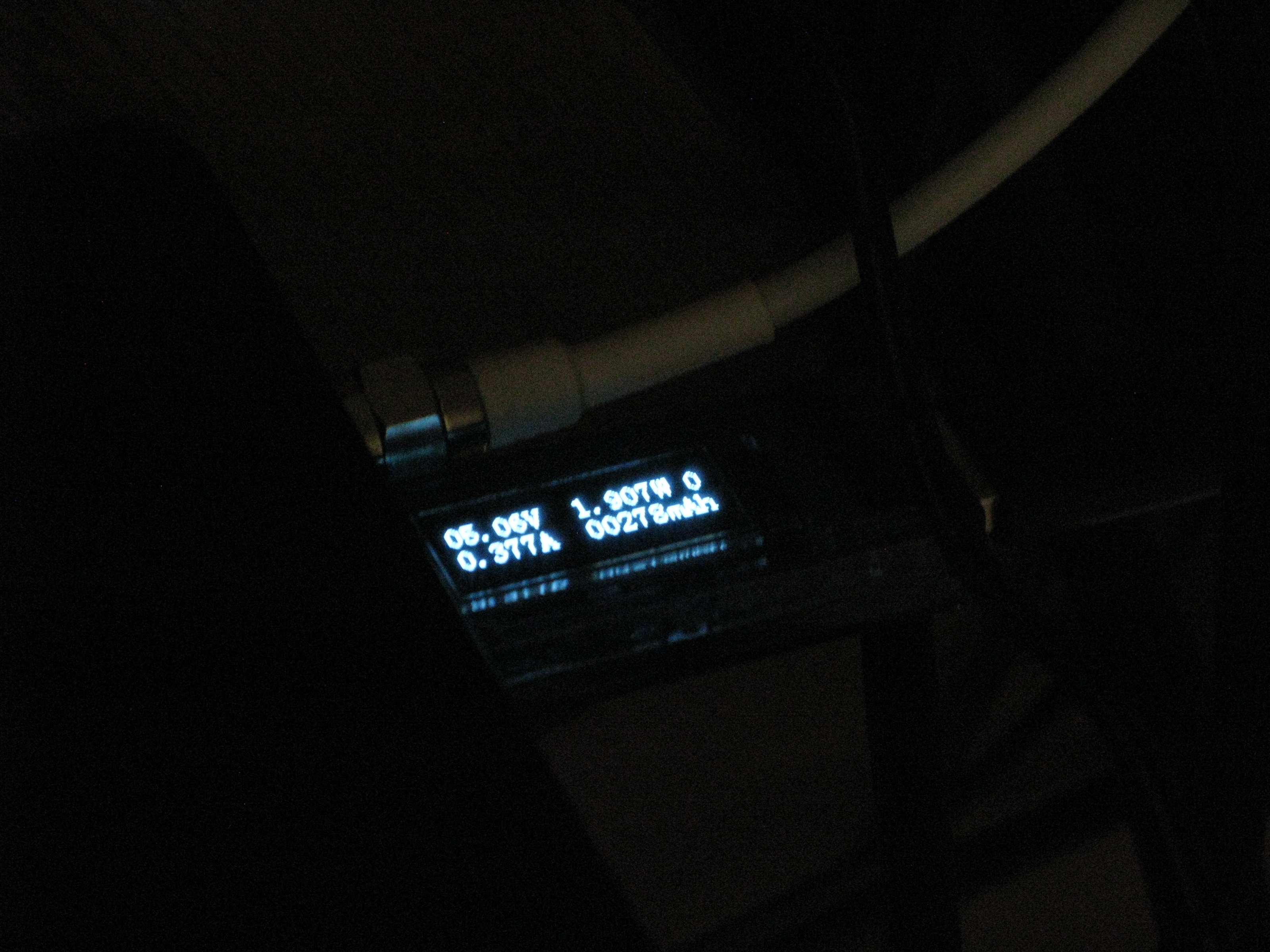

Since we have the same model drive, I’ll report back with my power draw readings, and then you’ll know how much a working Tablo, and hard drive should use.
Okie dokie.
We have the same model USB hard drive.
Mine is drawing this much when idle…
Mine is drawing this much when recording…
Since 5 volts at 0.5 amps (500 milliamps) is the maximum power a typical USB port can provide, it looks like this drive should be well within the power draw specification limits.
If your Tablo reports that the drive exceeds its USB power draw limits, then there’s something wrong with the drive, or something wrong with your Tablo’s USB port.
