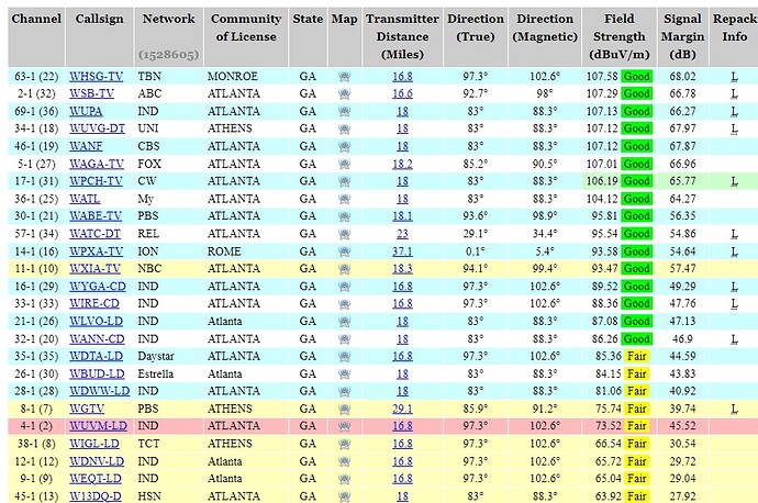

@andyross I’ve attached a copy of the rabbitears.info. The search distance is
60 miles.
Looks like a generally due East direction should pick up most. You should be able to get all the main networks. It looks like NBC would be the weakest.
To add, if you still have issues with the flat antenna (make sure the center conductor is not damaged and straight on all connectors) you may need to try something else. If outside is not an option, then you can try some Antennaman has reviewed as good.
Pricey, but should be good is the Televes Dinova Boss Mix. It can be used inside or outside, and is small enough that it could be hidden outside if you can a decent spot. This link is direct from Televes, but you can find it elsewhere.
