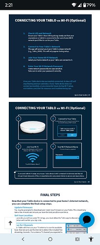

It was a simple process when I did it for the gen 4 a couple of years ago. Assuming the gen 4 has never been configured for WiFi you just unplug the gen 4, unplug the ethernet cable, apply the power and use you phone to search for the gen 4 private network SSID and connect.
Of course that’s if you phone has the feature and it’s turned on. Things may have changed in the last year or so and not necessary for the better

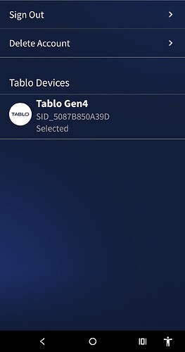

Go into the mobile app and look on the right side for your profile. Select
See which device the app knows about.
