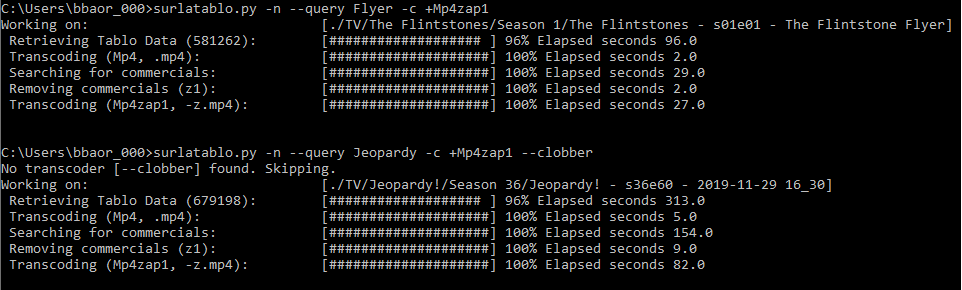

I just installed SurLaTablo and am experimenting with commercial skip. Both examples below yielded a full recording and another recording that was about 1/3 the length of the original,(presumably the zapped version?). Am I doing something wrong?
For game shows you’ll likely want to add -o postscript=True (and any show that might have a very short end piece at the end)
But other than that, looks like what you’re supposed to do.
Edit: Note, you can’t add options after the transoders (e.g. --clobber)

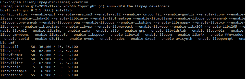

Make sure you’re running the latest version. surlatablo.py --version, should be running 2.3. Can you say what OS you’re using and what version of ffmpeg you’re using? ffmpeg -version
Windows 10
Do I need to put ffmpeg in my path? I actually have two different ffmpeg versions on my PC but I point to the one below in the conf file. I have actually tested with both with the same results. I will remove the one I no longer use.
Looks like your ffmpeg is a dev build out of git. Which I would think would be ok. Not sure why things aren’t going right. But again, while I suspect maybe something else, black frame detection can make mistakes, but requires sporadic black frames in the true content.
