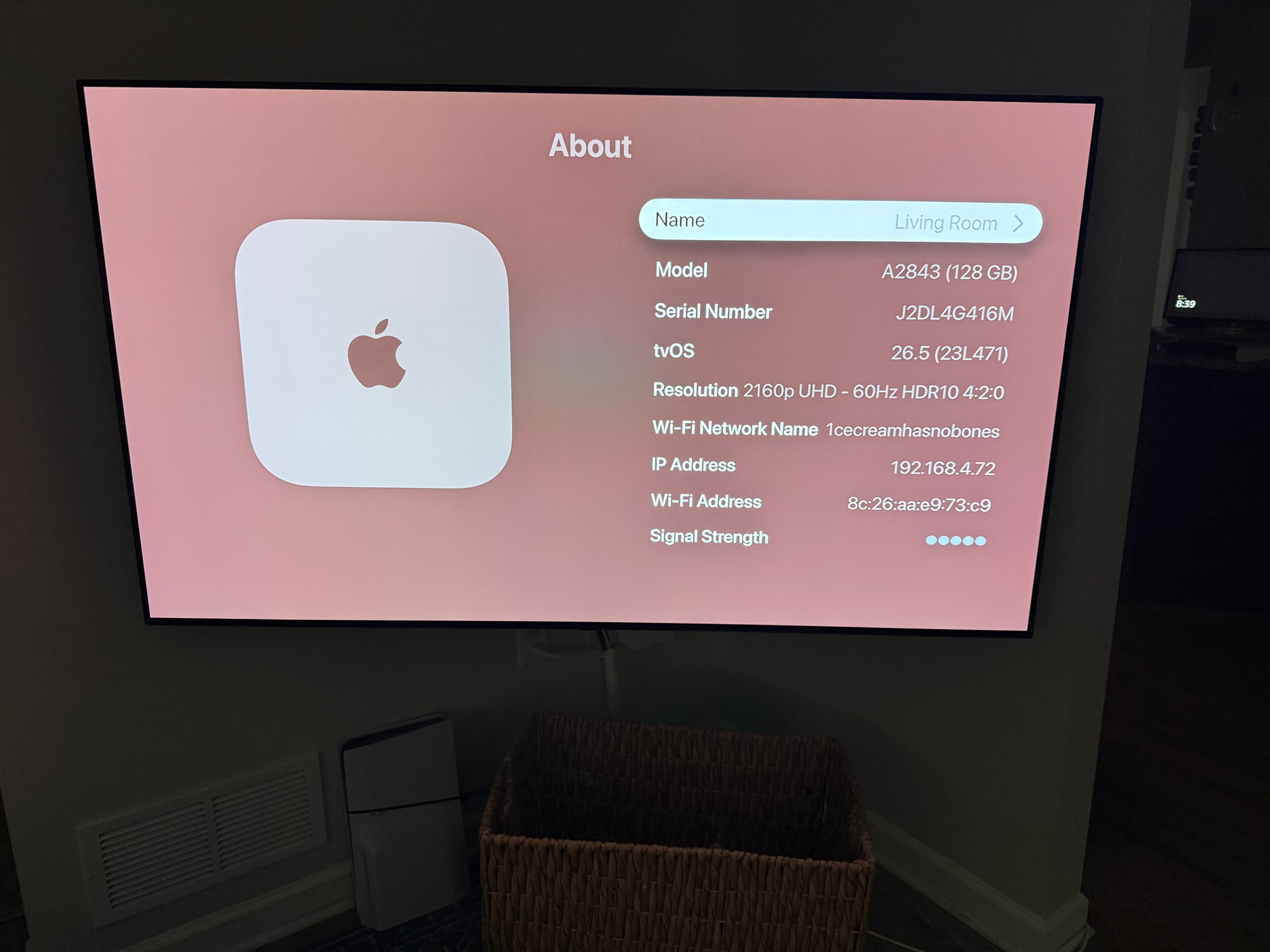

Hey @SteveHas,
If you would, would you check Apple TV Settings → General → About → Model and share with us the tvOS version and models of your Apple TVs? Noting which ones work and which ones do not.
everything is up to date
All 3 are running TVos 26.5
