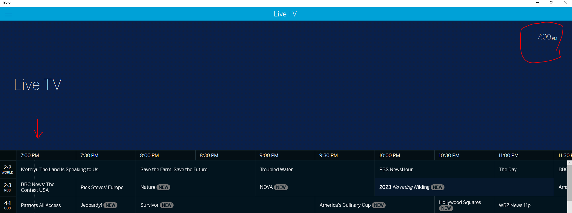

No, had my fiber ISP for years. I’ve checked, power reset, and verified that the network time is correct on both my 4th Gen (on which I can record from the OG with no issues) & Legacy units. The ‘time-shift issue’ I have is only on my Legacy manual recordings, and only started when I upgraded to the latest firmware for that unit. Don’t know what the issue is, but I’ve learned to 'live with it." Thanks for your comment.
My Tablo has the correct time as shown on the guide.

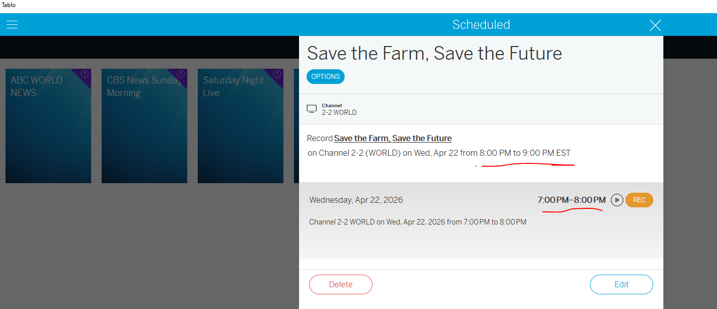

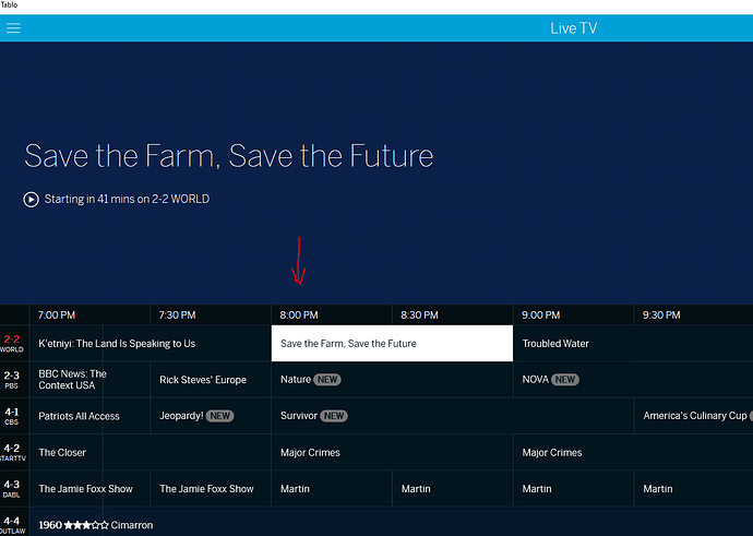

When I schedule a recording, the time again foe the recoding is correct. The episodes that it adds are showing an hour earlier start than what the recording says. I opened a ticket and developers are looking into this.
goto scheduled…
NO change. Same internet, same router. Just an update to 2.2.58 code.

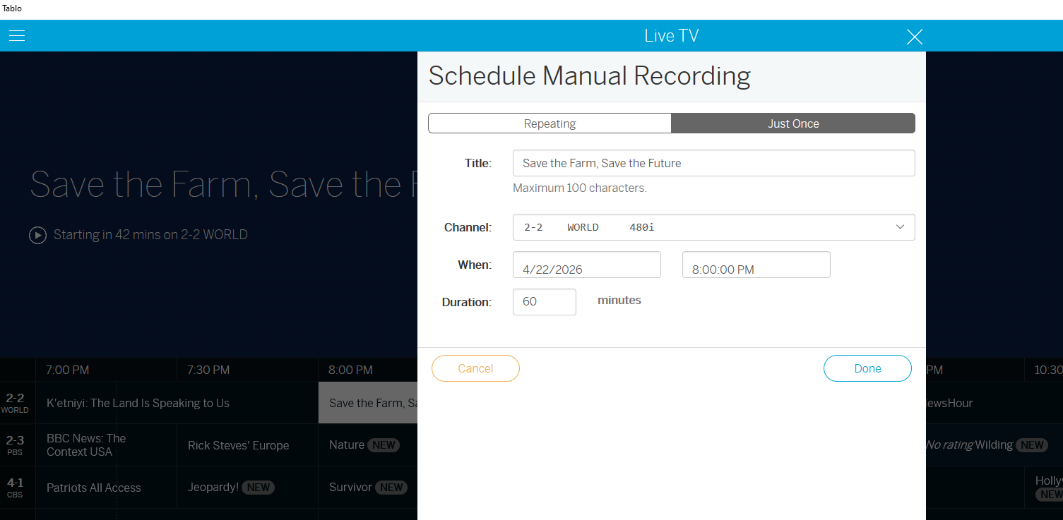

We’re still looking into this, but it looks like a possible issue specifically with manual recordings for those without guide subscriptions. We’ll be looking into solutions, but if you’re interested, you could try now using our 4th gen apps to connect to your Tablo, and would then be able to access full features and scheduling capabilities.
To do that, you’d need to download either the Apple iOS or Android mobile Tablo 4th gen app. You’d then create an account and then select your current Tablo with it, and it should guide you through the short transition process that will involve a new channel scan. Once that’s completed, you can continue to use it on your mobile device or download the 4th gen app on most of the main TV platforms and set top boxes. Unfortunately we do not support a new browser app at the present time.
