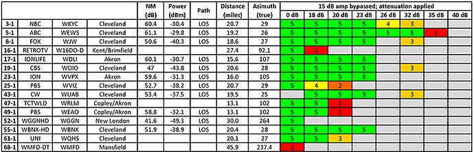

Yes, when I first posted it was surmised that my signals were suddenly too strong (because of the loss of foliage), so I played with different combinations of simply removing the amp and then also adding various magnitudes of attenuation. I determined that I could add 23 dB of attenuation (in addition to removing the 15 dB amp) before any of the strongest stations started to drop below 5 green dots.
I ended up leaving 18 dB attenuation on the line (to save the PBS signal out of Akron I covet), along with bypassing the amp, and the problems persisted. I removed the attenuators but left the amp bypassed for a while, then just went back to my original setup with the amp engaged to pursue other avenues of troubleshooting.
EDIT: This thorough test is what leaves me pondering how Tablo Support is identifying evidence in the logs of weak signals being the cause of many of my errors. I’ve been operating at full strength – 15 dB amp engaged and MINUS any of those attenuators for a couple of months at least, certainly the entirety of the time that Support has been monitoring my logs.
