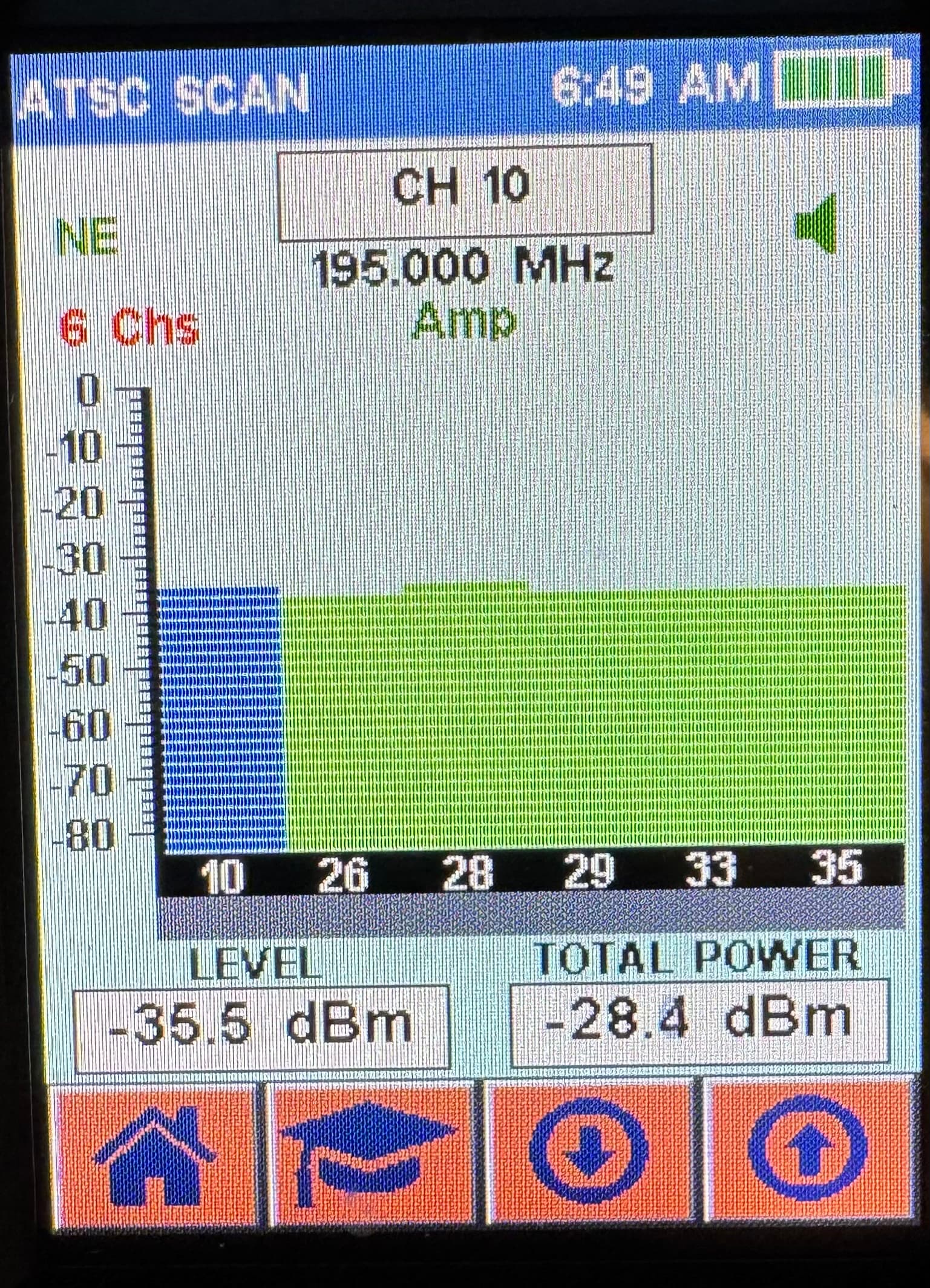

Here’s a picture of what the Televes digital filtering can do with a bunch of different transmitters (RF channels) coming in from the antenna at different levels:
This is from my Televes Avantx output as measured by my RF meter.RF channel 10 is highlighted in blue, but there are 5 other channels also shown on the chart. y-axis is level.
