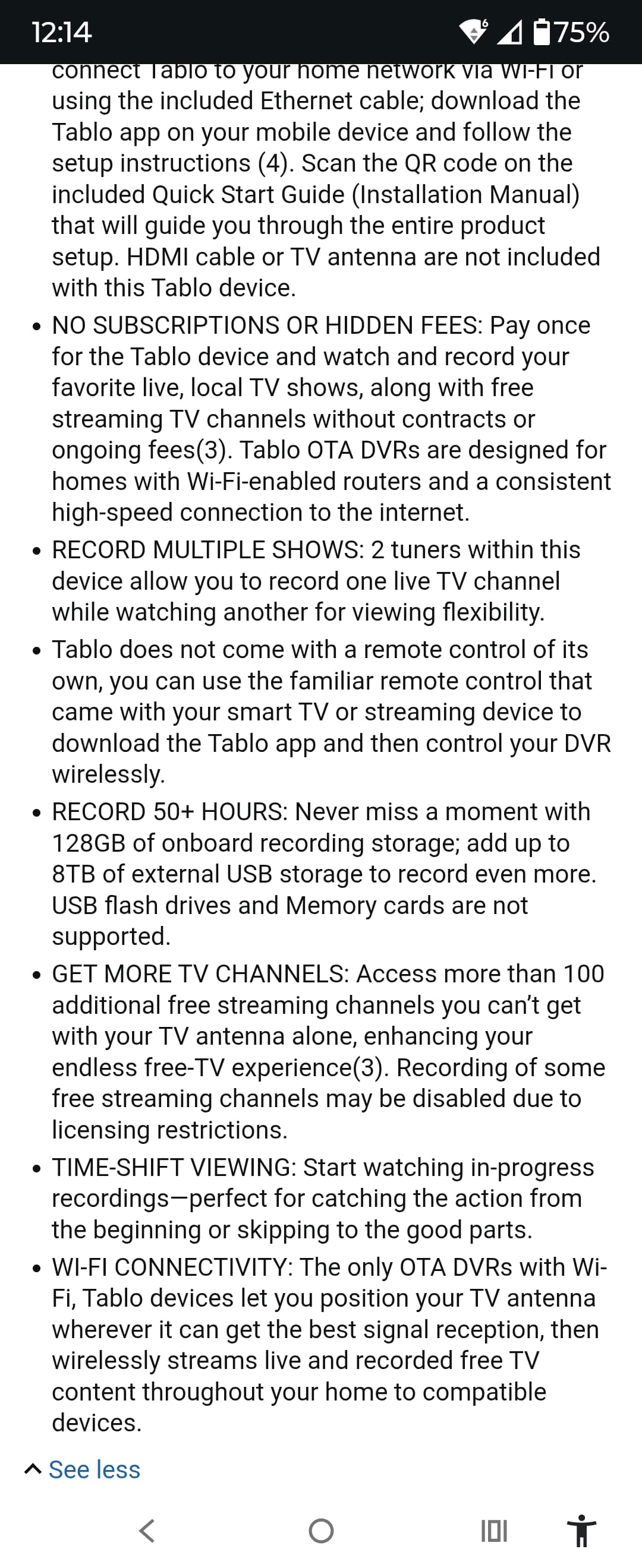

TF1284B-01-CN Google search says 4 tuner at Best Buy but Amazon says 2 tuners. You cannot trust the description on many online products because they copy and paste them.
That would not explain how you recorded 4 OTA channels simultaneously. My experience has been to get a different customer service representative.
It was purchased from Tablo through Amazon (Tablo was listed as the actual seller) and showed four tuner - I was coming from a prior generation device with four tuners, I wasn’t about to downgrade. My Amazon receipt even shows four tuners. Tech support is digging deeper into this now.
